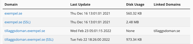

- If you scroll down a bit on the page, you’ll find a table containing the available logs. If you click the doman name in the
Domaincolumn, you will get to download a gz-compressed file containing the log.
In the table you’ll see the following:
- Domain: Shows which domain the log file is for. Keep in mind that traffic towards http is logged separately from https. The latter is labelled with (SSL) next to the domain name.
- Last Update: Timestamp of when the log file was last updated.
- Disk Usage: How much disk space each log file uses. A large file means that there has been a lot of traffic going towards the domain.
- Linked Domains: Here you see what addon domain that represents the domain visible in the
Domaincolumn.
If you scroll further down on the page, you will see the header Archived Raw Logs. If archiving is activated (see below), you will reach these older logs here.

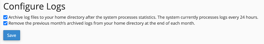

Activate archiving of logs
Access logs are being rotated once per day, so if you want access to older logs than for the last 24 hours, you need to activate archiving of logs. To do this, follow these steps:
- Begin by logging on to cPanel.
- Click the icon
Raw AccessunderMetrics.
- Under
Configure Logs, check the checkbox next toArchive log files to your home directory after the system processes statistics. The system currently processes logs every 24 hours..
- Don’t forget to click
Saveafter adjusting the settings.
