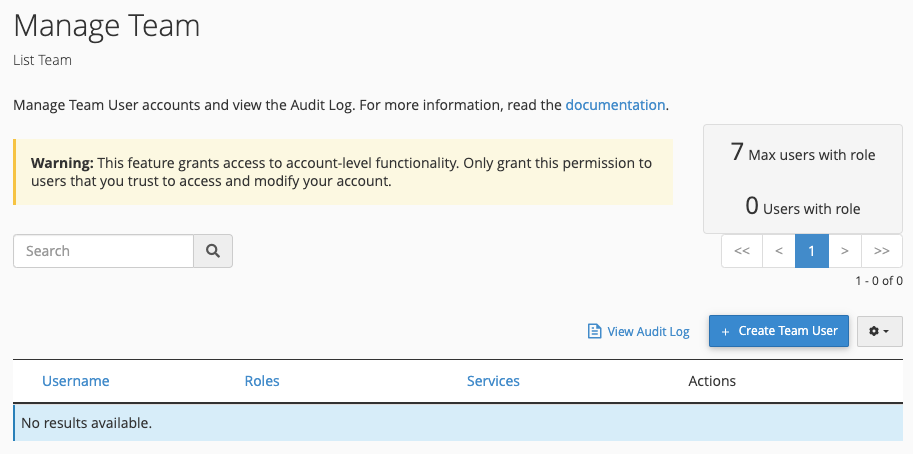

Accessing the feature
To access the feature Manage team, do the following:
- Begin by logging on to cPanel. For this, you need to use the main user account of the web hosting account and not any account previously created via the Manage team feature.
- Click
Manage teamunderPreferences.
- You will now access the interface where you can manage the different users you want to set up (or have already set up) in the team.

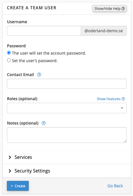

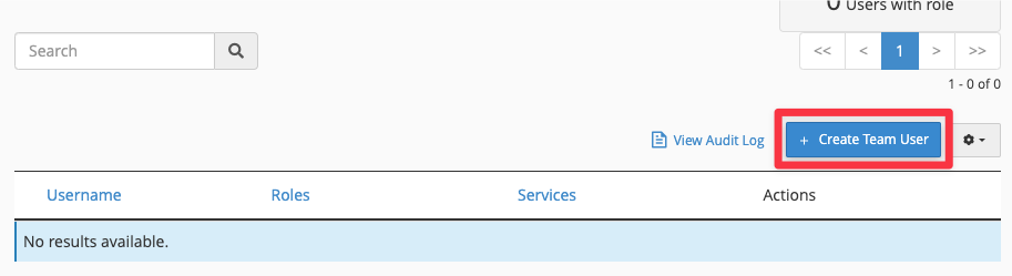

- Start by accessing the
Manage teamfeature as instructed above. - Now click on the
+ Create Team Userbutton.
- You will now reach the interface where you can make settings for the new user.
Here you enter the settings as follows:
Username: Give the user a username. The name will be in the format your_selected_name@web_hosting_account_main_domain. So if you enteruserhere, the full username will beuser@oderland-demo.sebased on our example above, as the main domain isoderland-demo.se. The username can only contain the letters a-z and numbers, no periods or other special characters.
Password: Here you can choose whether you want to let the new user set their own password or if you wish to set a password for the user. If you allow the user to create their own password, a link for this will be sent to the email address you enter in the field below.
Contact Email: An e-mail address for the new user. This address is used for password resets and notification emails, for example. It is also used for a password link that is sent out if you choose to allow the user to create their own password in the step above.
Roles: Here you choose which roles the new user should have. There are four different roles, which broadly mean the following:
Administrator: Same permissions as the main account, with full access to all features of the hosting account, except for team management. This is unique to the account owner.
Database: Access to database-related functions on the hosting account.
Email: Access to functions related to email management, such as setting up/managing existing email accounts, forwarders, filters, etc.
Web: Access to the functions related to websites and their files uploaded on the hosting account.
Notes: Here you can write a note about the user account, for example whose account it is if it is not clear from the username.
Under Services, you can also enable email and FTP accounts for the user if you wish to do so. Please note that Webdisk is not available even though it is visible in the interface.
If you wish to time-limit the user account, this can be done under Security Settings at the bottom. - Don’t forget to click
+ Createwhen you are satisfied with the settings. You will also need to tick the checkbox in the yellow box that pops up and agree that you accept the security risks that may arise when handing out login details to someone else.

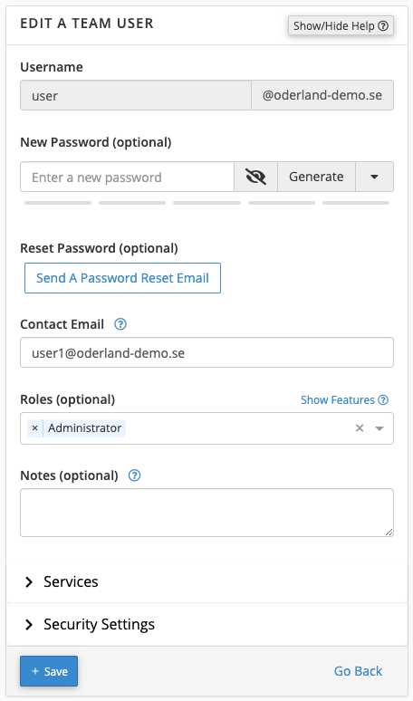

Manage teamfeature as instructed above. - In the list of users, locate the user you want to edit and click on the
Edit Userbutton.
- You will now be able to edit the settings for the user.
The settings are managed in the same way as when creating a new user as described in step 3 of the section above. - Click
+ Savewhen you are done editing.

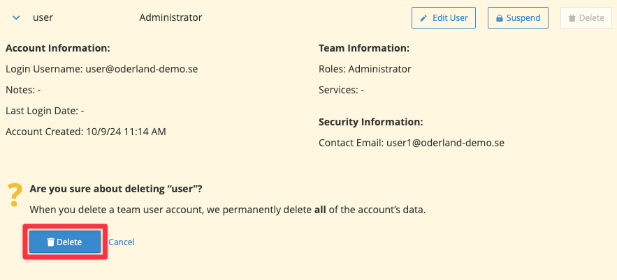

Manage teamfeature as instructed above. - In the list of users, locate the user you want to remove and click on the
Deletebutton.
- Now read the information on the screen and then confirm the removal with the
Deletebutton at the bottom.
- The user will now be deleted.
