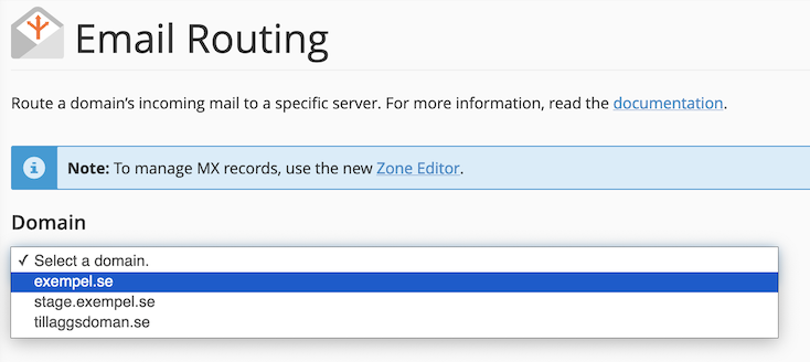

- Begin by logging on to cPanel.
- Find and click the icon
Email RoutingunderEmail.
- Now, select the domain for which you wish to check or change the email routing. The domain is the part of an email address following the @.

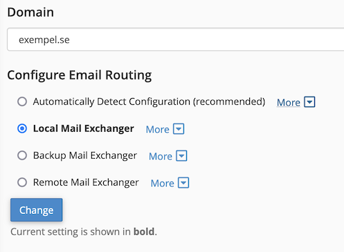

- Once a domain has been selected, you have four different choices. If you change the setting, don’t forget to click
Change.
- Automatically Detect Configuration: The server will try to figure out the correct setting on its own. This can however go wrong, and we recommend that you do not use this option, but instead set the email routing according to where the domain’s email is managed.
- Local Mail Exchanger: Our server will receive email messages for the domain. If your domain has its email set up on our servers, this is the correct option.
- Backup Mail Exchanger: Our server will temporarily keep incoming email messages in the queue until the messages can be handed over to the regular email server. This is an advanced option, and should only be used if you know why you need it.
- Remote Mail Exchanger: Our server will pass on messages sent to it. If your email is managed by another provider, this is the correct option to select.
