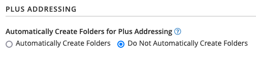

The default behaviour when using plus addressing is that if an incoming email message is intended to end up in a folder that doesn’t yet exist, the folder will be automatically created. You may change this setting via cPanel for the web hosting account managing the email account.
If you do not wish folders to be created automatically, follow these instructions:
- Begin by logging on to cPanel.
- Click
Email AccountsunderEmail.
- Now click the
Managebutton to the right of the email account for which you wish to edit the setting.
- Scroll down until you find the
Plus Addressingsection. Here you may edit the setting regarding automatic folder creation.
- Once you’re done, click
Update Email Settingsto save.
