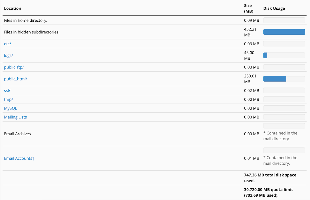

cPanel will now analyse your account, going through all files to check how much disk space everything uses.
Once everything done loading, on top, you’ll see a list of all folders in your home directory and how much space files and folders within them use. Here you’ll see the first clue to what uses up the most space. E.g., if you see that the folder mail has the highest disk usage, your mail accounts fill up the account the most. On the other hand, if the folder public_html has the biggest disk usage, it’s probably one of your websites that use the most space.

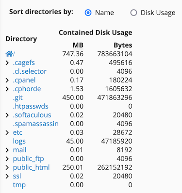

If you scroll down on the page, you will se a list of all folders in your home directory. Here you can drill down into the folders and investigate more deeply what uses your disk space.
Once you’ve found a folder you wish to investigate, click the tiny arrow to the left of the folder’s name. Now, the folder will expand and you’ll see how much space the various folders contained inside uses. In this example we check the public_html folder.

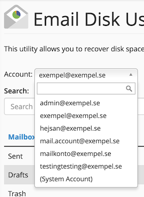

After clicking the icon, you will be shown the default email account (indicated as System Account in this interface). All web hosting accounts have a default account for email, however, it usually contain no email messages. All email accounts created can be seen in the dropdown menu by the top, next to Account. Select an account to see its details.

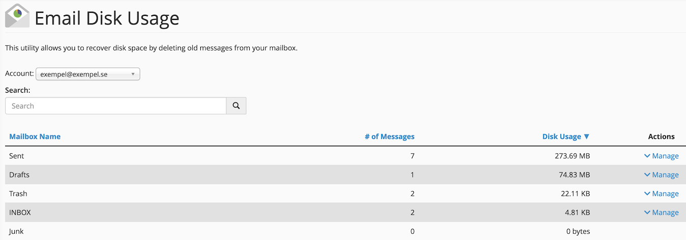

The image below shows that the Sent folder contains more than 270 MB. If you click Manage to the right, you will see options for e.g. removing email messages based on how old they are or how much space they use.
Once you’ve selected what kind of messages you want to delete, click the Delete Permanently button. The messages that match your selection will now be deleted and you will gain access to additional disk space.
