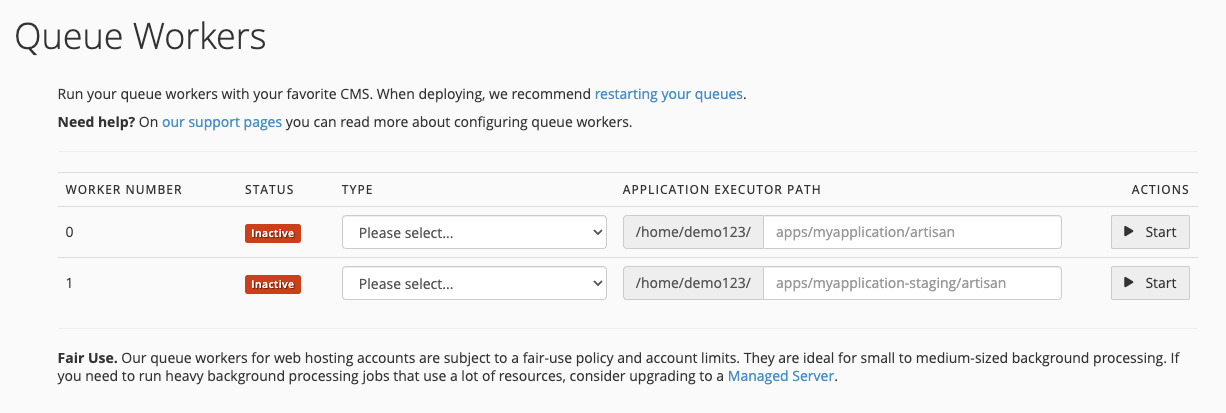

  3. You will now be able to configure up to two queue workers, for example one for your production environment, and one for staging/development.
Managing workers
Once you accessed the settings for your workers (as described above), you have the following configurable options (settings for production and for staging/development are set up in the same manner):
  • Worker number: You can have up to two workers per cPanel account. This is the identifier for them.
  • Status: Here you’ll see whether or not the worker is active.
  • Type: What type of worker you’ve set up (Laravel Horizon, Laravel Queue, Symfony Messenger, or Craft CMS Worker).
  • Application executor path: The path to, for example, the project’s artisan file.
  • Actions: Here you can Start or Stop your worker.
You can control a worker via SSH if you’d like. This is done with the following:
uapi QueueWorkers update action=start|stop|restart [worker_number=0|1]
Choose between start, stop and restart, and enter the number for your worker (0 or 1).
