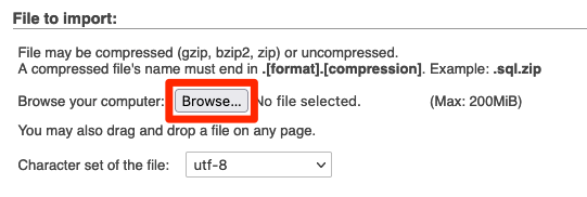

- Click
Browseand select the SQL file you wish to import.
- Select
SQLas format, if it’s a SQL file you’re about to import. Finally, clickGoat the bottom of the page.
